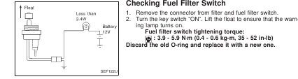

Rumcajs Posted November 3, 2015 Report Posted November 3, 2015 Patrol OEM filter housing uses little float which connects to ground when lifted up by water inside the housing as it is more dense than fuel. Or just unplug the connector and bridge the terminals inside, the light should come on. Cheers ricster and skid 2
skid Posted November 6, 2015 Author Report Posted November 6, 2015 Just tried shorting the wires as you did but the engine light came on not the water in fuel light, so they must have stuffed something up when they did the conversion, but at least I have some form of light on the dash coming on, engine light is better than nothing.....
Rumcajs Posted November 6, 2015 Report Posted November 6, 2015 (edited) Sorry bud, they didn't really stuffed up, they just left it as on ZD30 where filter warning is connected to MIL (Malfunction Indicator Light aka engine check lamp). Because yours is ex ZD30 model you dashboard doesn't have filter light decal but MIL decal instead. If yours was OEM TD42 it wouldn't have MIL decal but filter light. Its all in the decals as pinouts on both displays are the same. As a matter of curiosity on TB45 (petrol models) it is immobilizer light. Abbreviations: EG ==> ECM (e.g ZD30) models MIL/Check Engine TD ==> TD42 fuel filter SN ==> TB45 immobilizer Regards Edited November 6, 2015 by Rumcajs skid 1
