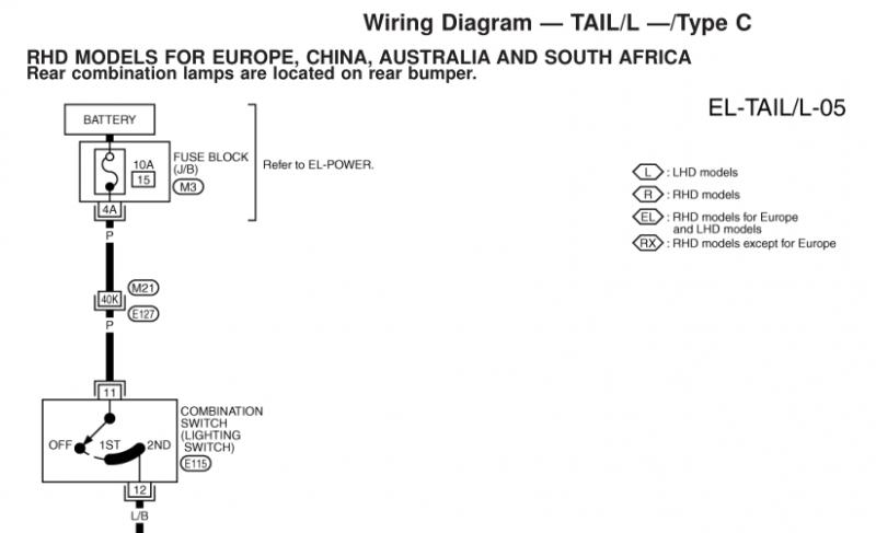

Yendor Posted February 8, 2015 Report Posted February 8, 2015 It will more then likely be a blown stop light fuse causing all 3 problems. The stop light fuse is fuse number 14 in the fuse box inside the vehicle. It's a 10amp fuse. If the fuse is blown you will need to find the cause. Start by checking the trailer plug and it's harness for possible damage.
