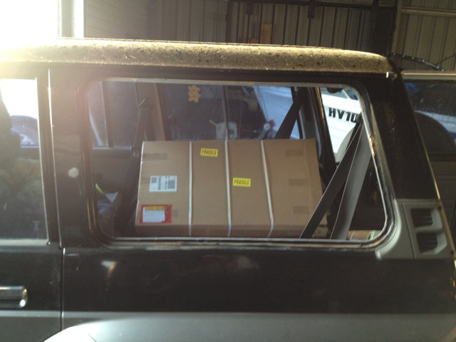

BigGQWesty Posted August 9, 2012 Author Report Posted August 9, 2012 (edited) Well there in and I'm stocked.. Very clean and very easy to do. But you need 2 people.. Used a 5mm rope and fed it around inside the rubber were the lip will eventually end up. Allow a good 30cm overlap and have the tails to the inside. Next was to pull the old ones out. Another easy job. The inside rubber is simply peeled away and push the frame out.. Make sure you have some one to catch.. Next we simply placed the window in position and while the outside person applies light inwards pressure you pull the rope out and the rubber will simply roll over the body lip.. Use plenty of soapy water. The corners are a little tougher and a screwdriver is handy to aid the rope. All in all 45mins and there in.. Edited August 20, 2012 by BigGQWesty Robbo of the roads 1
BigGQWesty Posted August 20, 2012 Author Report Posted August 20, 2012 One empty hole.. Installed.. And very clean IMO Fathom and Robbo of the roads 2
