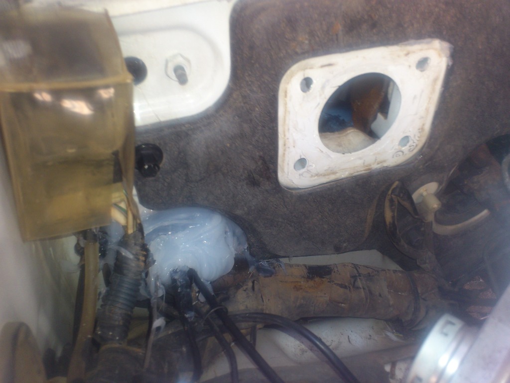

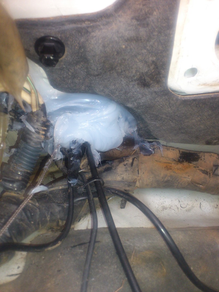

gottheshits Posted July 6, 2012 Report Posted July 6, 2012 So the water runs sideways toward the wheel arch? Thats a bloody clever idea. Ill be doing the same Very nice tip and thanks for the pics! No in towards middle of vehicle. Silicone up next to the guards so the water has to go that way.
Tonka Posted July 7, 2012 Author Report Posted July 7, 2012 Ive changed topic title in case others are having same issue, easier to index this way.
Tonka Posted July 7, 2012 Author Report Posted July 7, 2012 Ive got the booster out, much easier to work on the issue now. I even have a suspicion that it could even be leaking thru there as the gasket is completely shot.

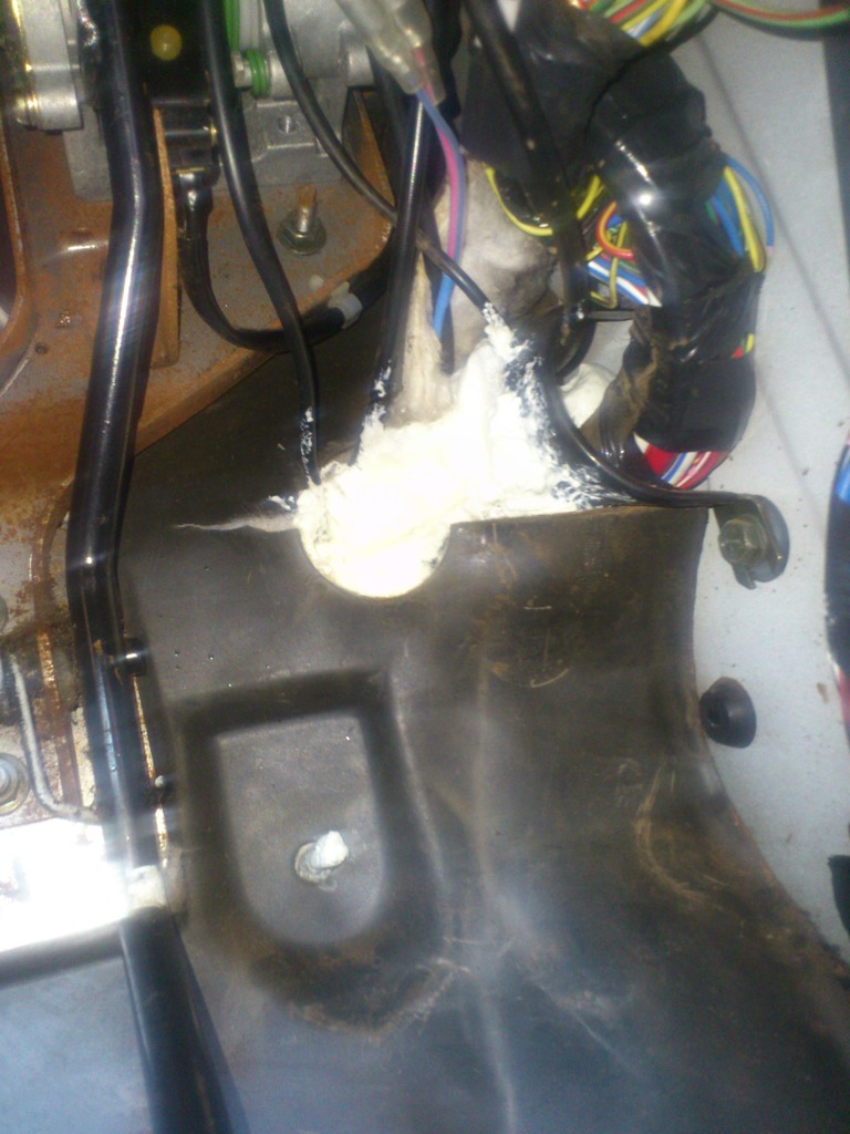

Tonka Posted July 16, 2012 Author Report Posted July 16, 2012 Some pics of the brake booster removed and the grommet flooded with silicone, also a pic of the grommet inside with waterproof spray foam. That foam stuff is the ducks nuts
Tonka Posted July 16, 2012 Author Report Posted July 16, 2012 Tomorrow im going to add the angle to divert even more water away from the area
gottheshits Posted July 16, 2012 Report Posted July 16, 2012 Good job mate. How much effort was it to get the booster out.
Tonka Posted July 16, 2012 Author Report Posted July 16, 2012 Yeah its a wrestle. The easy way would be to drain the brake fluid and remove master cylinder (im not confident in that). I opted to remove the fuel filter bracket and wrestle the booster out. The top right nut on the inside of the truck is an absolute bastard, zero room for hands.
