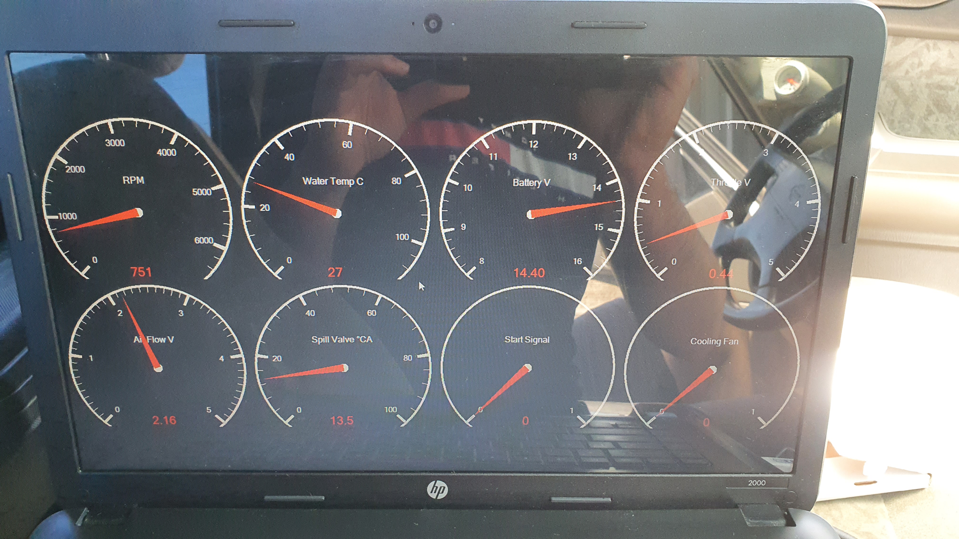

bistratoaie Posted November 2, 2020 Author Report Posted November 2, 2020 (edited) So I just got my ECUTalk cable today and these are my readings on first start up of the day 26°c outside. Do these readings look okay so far @Rumcajs? Am yet to diagnose my glow plugs. Edited November 2, 2020 by bistratoaie
Rumcajs Posted November 2, 2020 Report Posted November 2, 2020 (edited) 8 hours ago, bistratoaie said: So I just got my ECUTalk cable today and these are my readings on first start up of the day 26°c outside. Do these readings look okay so far @Rumcajs? Am yet to diagnose my glow plugs. Hello, Finally you're cooking with gas..... The most important gauges are: RPM, Water temp, Battery V, Throttle V or %, Injection Timing % (duty cycle), Air flow, Barometer, Fuel Temp, VNT Turbo %. MAF Voltage seems a little higher for idle.... If Injection Timing % is bellow 40% you have air in the system or problem with fuel. Normal operation around 50-70%. So in yours, barely reaching 41% at idle yes you have problem with fuel delivery. add external lift pump and you will find the leak quickly. However you MUST carry out SPILL/OVERFLOW LINE modification otherwise you will pump fuel backward in to the injectors and cause major failure. In this imbecilic design of the injection pump fuel is used to cool, lubricate as well so not enough or starvation will destroy the injection pump very quickly. Fuel starvation is the most common reason for the pump failures. One way to mitigate is to add external lift pump like carter 4601 to Walbro 13-2 ....The arseholes from Bosch who ripped this design from the UK have caused so much heartache and financial damage to the owners of those cars with that abomination VP44 radial injection pump. But generated a handsome profit for the manufacturers! Just search VP44 failures on Internet! Fuel temp is also very important keep in mind it depends a lot on ambient temp but continuosly above 60-70 C will spell trouble for the pump. Yours doesn't show turbo boost (absolute pressure), mine does so yours is series 3 and less. Air in the fuel is very difficult to diagnose, one thing to remember is that if the fuel pipe from the tank is compromised then air will get in. Another source of air getting in is primer on the top of the fuel filter. I'd also check hoses on the fuel tank, under the cargo space is a cover to reach to the pick up. One resort is to use a jerry can and rig up temporary fuel delivery to by pass pipes and tank to see if the air is sucked in at filter housing. Or if you have access to air compressor and regulator trick is to remove fuel line at the pump, block it with a bolt or something then remove fuel line at the tank pickup and pressurize the fuel line and find where air is leaking if any, or get a spare tank cap and drilled and fit airline fitting to it. (that's how it is done by some workshop or some manufacturers. Remember low pressure only (max 100 kpa ). I'd avoid driving the car until you identify why Inj Timng C/V % is low. If you wish, warm up the engine and go for test run around the block and check what you get at WOT (wide open throttle) Anything bellow 30 is massive trouble! You can log the data from those gauges in ECU Talk in to CSV sheet and open it in Spreadsheet app of your choice or just text editor. Set up log for the Inj Timing C.V %, RPM and throtle % so you can collate the data and see instead of starring in the laptop screen while you drive. Regards Edited November 2, 2020 by Rumcajs
bistratoaie Posted November 2, 2020 Author Report Posted November 2, 2020 (edited) Ah yes, the higher reading is due to a 3" straight through exhaust and the EGR blocked off which I read on another thread that 2.15v is okay on idle however; I did notice it linearly got to 4v around 3000-3500rpm while revving and watching the voltage. I do believe I have air in the system from the "3rd small o-ring" at the fuel filter primer because the fuel filter was replaced last month and I think they may have lost or forgotten that o-ring as the primer doesn't stay hard over a few hours or overnight and I have to prime it 3 times before it goes fully firm and I can start it so I'm thinking that's my issue until I can confirm it tomorrow when I check! What is an external lift pump and how easy is it to add? Is there a thread for it? I will check all the fuel lines and clamps and under the cargo and see what I find from there on. How do I bleed the air though? This is the main thing. Thanks for the reply Edited November 2, 2020 by bistratoaie

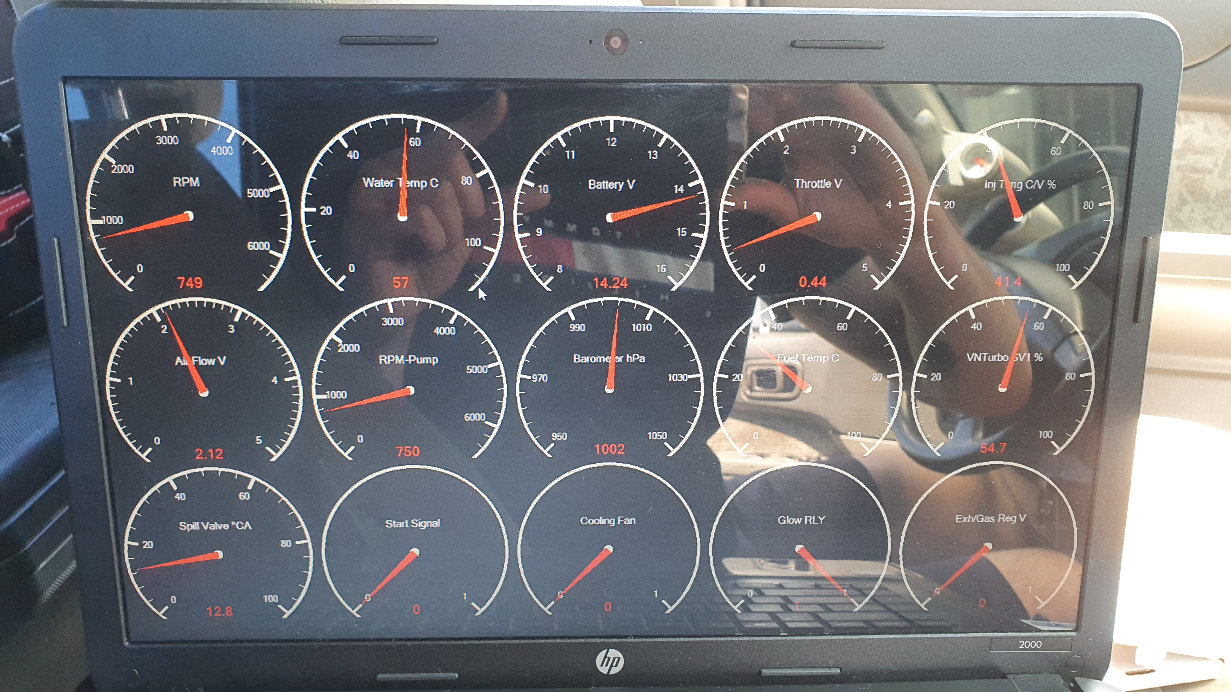

bistratoaie Posted November 16, 2020 Author Report Posted November 16, 2020 @Rumcajs I managed to finally get some clear 10mm hose to see if I can see any air going to the IP and relate to the ICV% and this is what I found. **Can't upload videos here at the moment. Video 1: idling (after 3 days of not starting it); A couple of little bubbles in the line to IP but then was all just diesel flowing through, watched it for about a minute and no bubbles. ICV% was at 34-38%. Video 2: holding revs @ 2000prm correlating to ICV% values; Still no air that I can visually see but after turning the car off the primer took 2 pumps to become fully firm again (maybe air getting in before the filter?) The ICV% values were at 42% @2000rpm then spiked to 57.8% when decelerating then stayed around 35% on idle again. How do these figures sound? Still no error codes just for EGR. 20201116_142040.mp4
bistratoaie Posted November 16, 2020 Author Report Posted November 16, 2020 I've also tried to do a log file like you said but when I open it on Notepad, I don't see any values correlating to the data that I was logging for the sensors I chose. How do I create a log and where do I find it/open it so I can see all the values? Cheers
Rumcajs Posted November 16, 2020 Report Posted November 16, 2020 That hose look clear so to me it doesn't have an issue with air in the fuel. However those ICV% are very low. At idle it should be around 50% as a minimum. Mine has around 63% with additional lift pump. ECU Talk creates log of your gauges as A CSV file is a Comma Separated Values file. All CSV files are plain text files, can contain numbers and letters only, and structure the data contained within them in a tabular, or table, form. I open mine in LibreOffice spread sheet to have nice collums. See here ==> https://www.ecutalk.com.au/ecutalk.aspx The key is to select only a data (gauges) you need otherwise it is too much and can get corrupted. Log file is created usually in the same directory ECUTalk runs from..... B/R

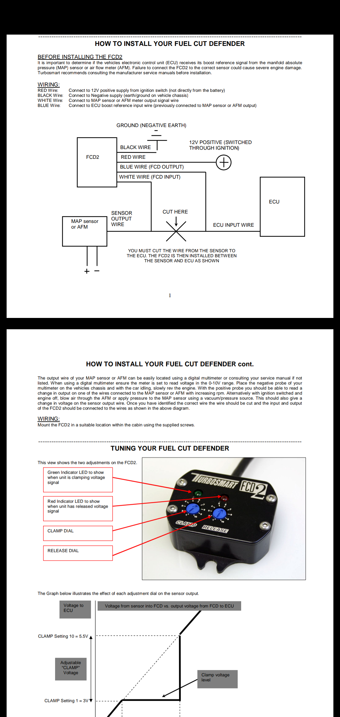

bistratoaie Posted January 17, 2021 Author Report Posted January 17, 2021 (edited) @Rumcajs So just to revive the thread back again, my original "hesitation" issue was the fuel cut from the ECU due to the MAF voltages being too high. Also managed to open the log files finally they started working properly and I could read the data! I have fitted a HPD boost controller just after I did the glow plugs and had it set to around 18 psi, it would occasionally hit 20 psi, I had a beep set on my gauge for an overboost warning but she drove fine. I had no issues since doing the work on it, even took it for a 4hr trip one weekend up and down windy roads etc and all was great, EGTs were good barely reached 400°c. The other day on a 50 minute drive to town, it started to hesitate just a couple of times and slightly, I was quite annoyed because it was very unexpected. I immediately pulled over and luckily had some tools in the car and I turned down the boost just a bit (16 psi) to try and avoid hitting the fuel cut. I still managed to get to town and bought some MAF cleaner to give it a good clean when I got home. On the drive home I only could manage to get to 80kph, I don't think it hit fuel cut but it was constantly stuck in a limp mode. When I got home I took the MAF sensor out and gave it a good spray to clean it, I also replaced all the vacuum hoses for the boost/turbo lines as some of them were old and frail from rubbing etc and made sure they were all on tight and zip tied, I also double checked the boost controller was set right and I am hitting 16 psi. Took it for a drive and it was behaving nicely didn't hesitate/ hit fuel cut but I'm wondering what the best option is to remove fuel cut/limp mode? I know they don't make the jaycar voltage modifier anymore and I'm not too sure about adding a diode/resistor in the MAF wiring, I have also read about the turbosmart FCD-2 as an option? I also know HPD make an upgraded MAF housing which apparently increases airflow by 30% and eliminates limp mode but I am a bit skeptical about spending $250 right now unless I know it's going to fix the problem, anyone have any ideas/solutions? Thanks! Edited January 18, 2021 by bistratoaie
Rumcajs Posted January 18, 2021 Report Posted January 18, 2021 Gday, Short answer is nothing works to eliminate fuel cut function from factory ECU. Need to remap the ECU to fix that issue. Don't waste $$$ on HPD gear, doesn't work especially MAF housing, I've got one, it creates more issues then it solves. Don't use FCD2 boost controller too, it doesn'twork. Over the time I've done it all. The only thing that worked is re-maped ECU. Then you need nothing else. The way fuel cut works is based on several factors: RPM, MAF airflow, time and TPS. Turbo boost is not taken in to consideration! E.g if RPM is bellow 2000, TPS over 30%, MAF above set limits for longer then 6 secs it will fuel cut to keep boost bellow 10 psi until reset. Another RPM point is @ 2700 and another at 3400. Its imposible to deal with. If you quickly release accelerator pedal it will reset. I obtained another ECU from https://ecpt.com.au/ and had it re-mapped and now my only problem is to keep the black smoke pouring out on take off behind me and backing off cause worrying about breaking something with that much power! The one and only mod, no need for anything else. Oh it will also expose weak clutch and shitty cooling with that much more fuel going in..... No need for boost controllers either, factory solenoid is enough. Regards
bistratoaie Posted January 18, 2021 Author Report Posted January 18, 2021 Thanks @Rumcajs I thought the HPD MAF housings & upgraded air intake kits were bigger to allow more airflow thus not allowing the MAF voltage to reach the limp mode? Or is it the other way around, bigger internal diameter means more air which means a higher voltage reading? Ah, I was reading that the Turbosmart FCD-2 basically clips the voltage to say 3.99V so that it cannot go into the limp stage? If it doesn't take boost into consideration, it says in the manual to either hook it into the MAF signal wire to the ECU or the boost sensor signal wire depending which one sends the signal to the ECU. Isn't the factory solenoid limited to 16psi roughly? So I can buy an ECU from East Coast Performance Tuning and get them to remap it or send mine to them to remap? How much did it end up costing you if you don't mind me asking?
