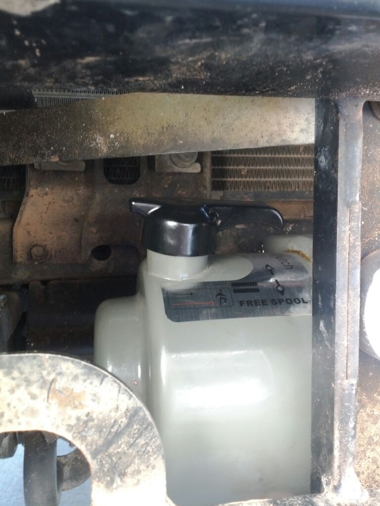

dronus4x4 Posted May 29, 2012 Author Report Posted May 29, 2012 Took my aldi winch off rotated gearbox than couldn't get it back on I have to try tomorrow when I get more patient and fixed my spotlight from rubbing on the bullbar I need to do this on my tigerz. I used it last weekend and getting to the handle could be easier if it wasn't pointing towards the engine! What did u have probs with? Lining something up? Interested to hear how you go. Sent from my Galaxy Nexus using Tapatalk 2

The Big Rig Posted May 29, 2012 Report Posted May 29, 2012 I need to do this on my tigerz. I used it last weekend and getting to the handle could be easier if it wasn't pointing towards the engine! What did u have probs with? Lining something up? Interested to hear how you go. Sent from my Galaxy Nexus using Tapatalk 2 Turning the gearbox was easy as I just couldn't align the bolts upto the bullbar and hold the winch in place at the same time

dronus4x4 Posted June 1, 2012 Author Report Posted June 1, 2012 Turning the gearbox was easy as I just couldn't align the bolts upto the bullbar and hold the winch in place at the same time Cheers if I can get a mate to help me get the winch in and out I'll give it a shot this weekend. Sent from my Galaxy Nexus using Tapatalk 2
The Big Rig Posted June 2, 2012 Report Posted June 2, 2012 If you go to YouTube there's a video showing how to do it on a tigerz winch

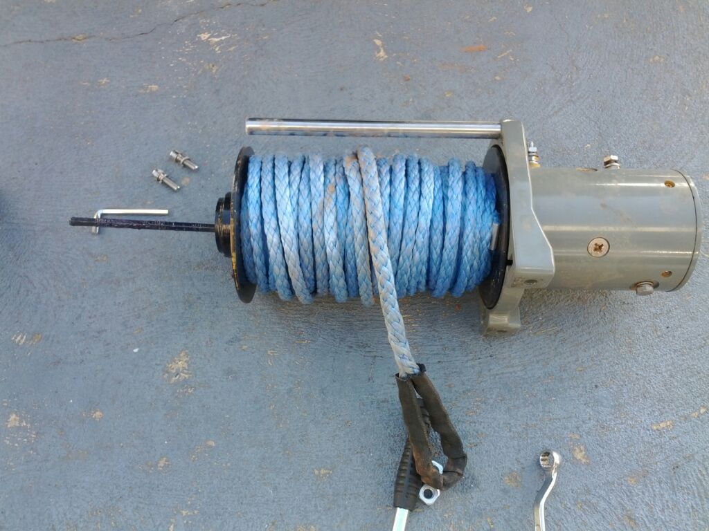

The Big Rig Posted June 2, 2012 Report Posted June 2, 2012 Just was thinking I don't know if its possible but. undo the gearbox mounts and see if it will slide off while leaving the motor side attached to the bar

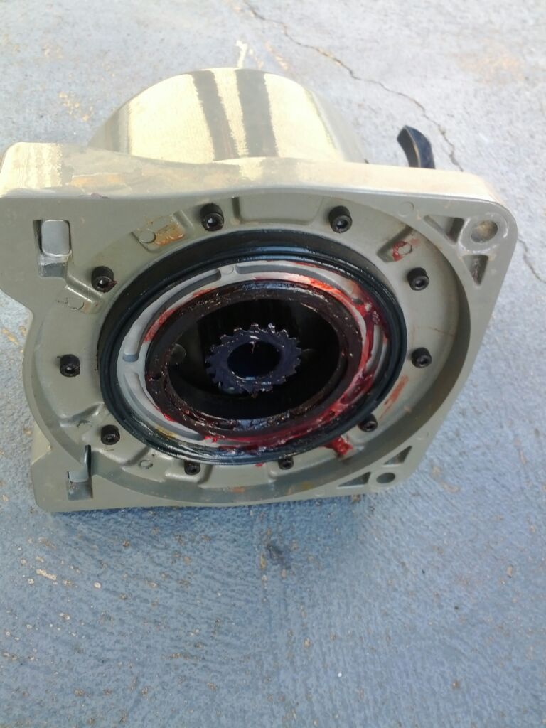

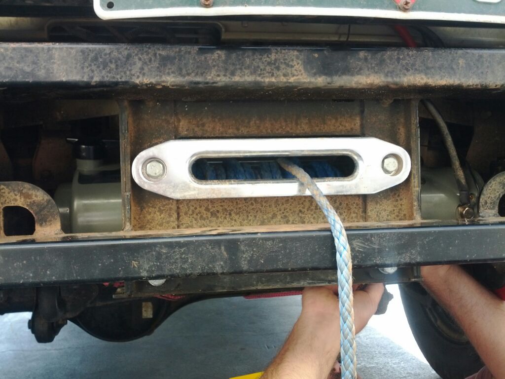

dronus4x4 Posted June 2, 2012 Author Report Posted June 2, 2012 All done. Was pretty easy in the end. Whacked some more htb grease in there while I was at it, and tightened everything up.. Sent from my Galaxy Nexus using Tapatalk 2
