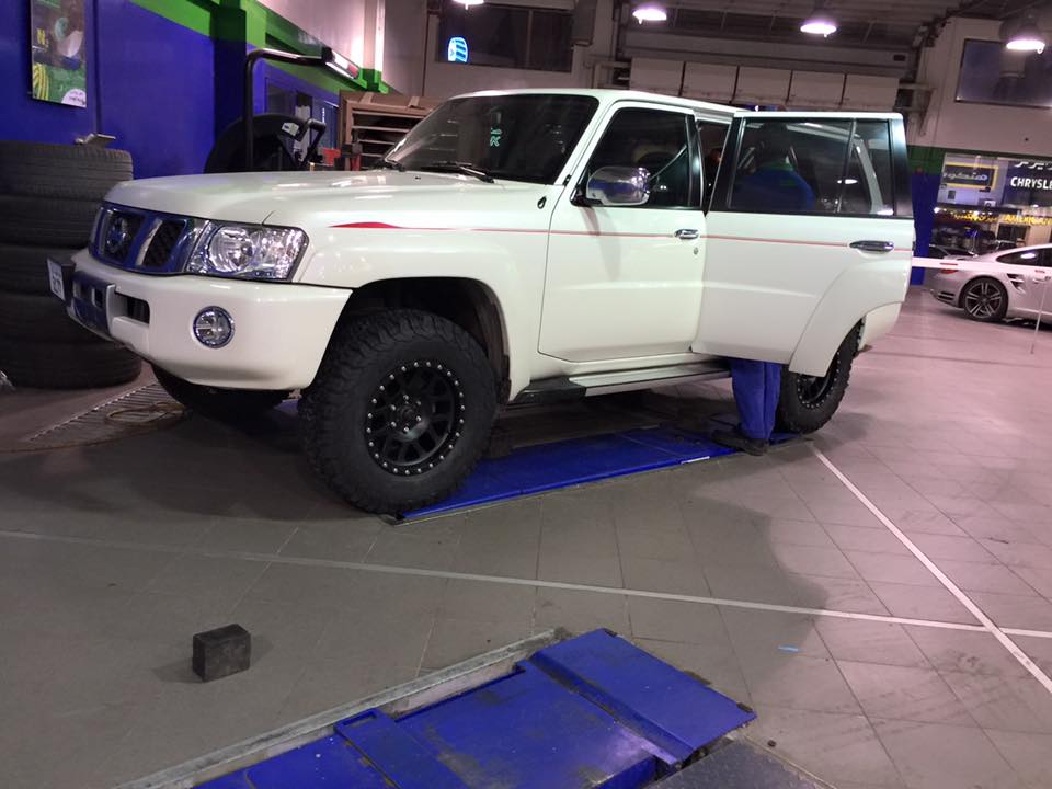

Mubarak Posted November 9, 2015 Report Posted November 9, 2015 after a long waiting and thinking I get my self a method wheels. Paul 1

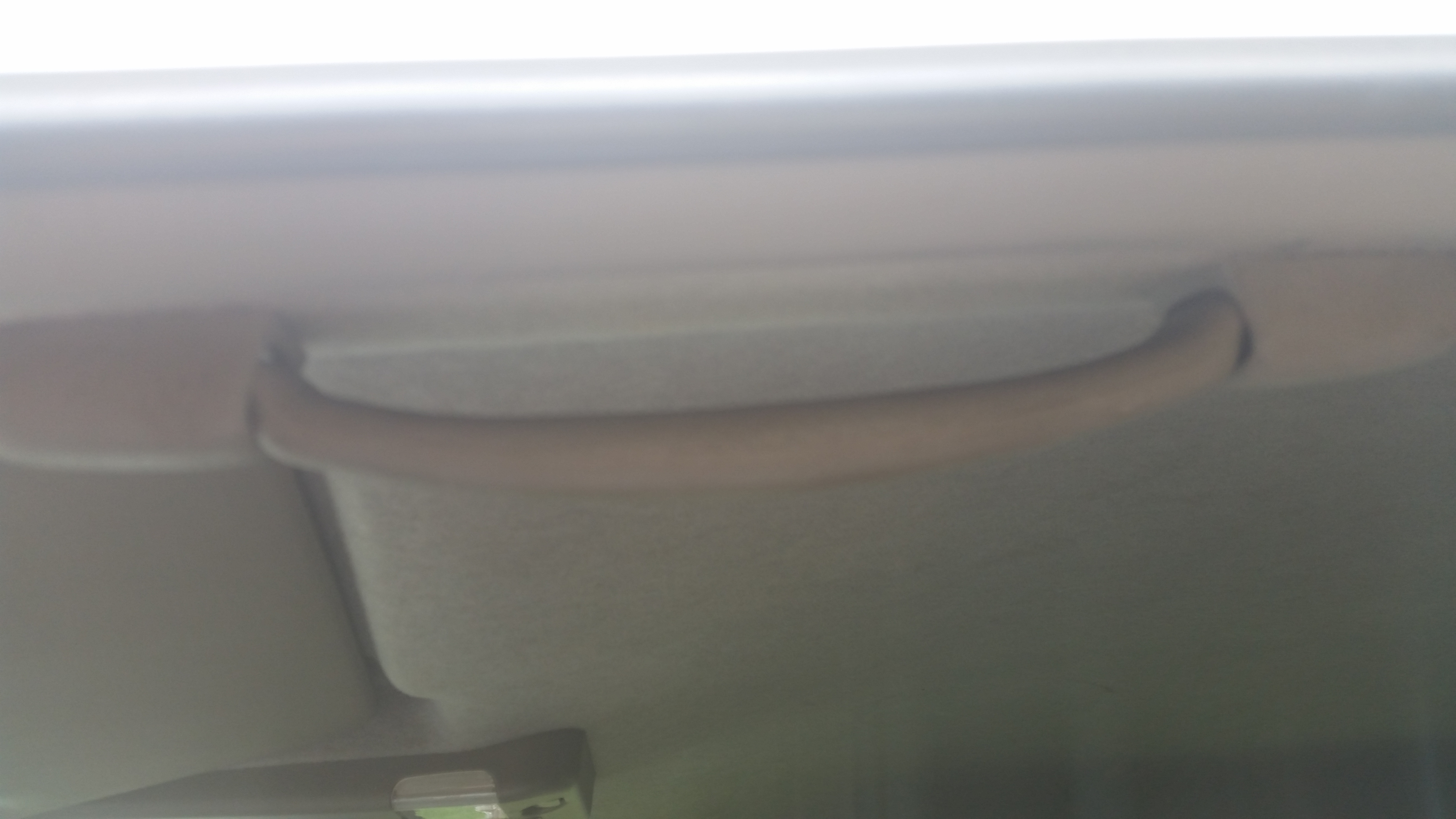

skid Posted November 17, 2015 Report Posted November 17, 2015 Put new panic handles in, the drivers side didn't have one, so got a pair from the wreckers and replaced the sagging passenger one and added one for the drivers side. Also picked up a bonnet protector and installed it as the screws were already there... Paul 1

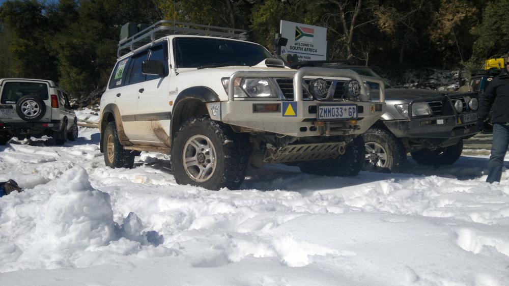

ricster Posted November 18, 2015 Report Posted November 18, 2015 Yeah, the std scoops are rubbish. I got the hell in one morning a few years back and got a scoop extender bent up from some scrap steel plate and then I cut a hole into the standard scoop and bolted the new steel on on top. This basically doubles the area for air to flow in, and is higher so hopefully getting better airflow onto the IC. One thing I had to be careful of was going too high and as a result obstructing my view over the bonnet. What I can tell you though is it DID make a difference of about 20 deg C to my EGT's. I can't find any pics here on my work PC that show the scoop other than these taken when we were traveling in the snow up high in the hills. skid 1

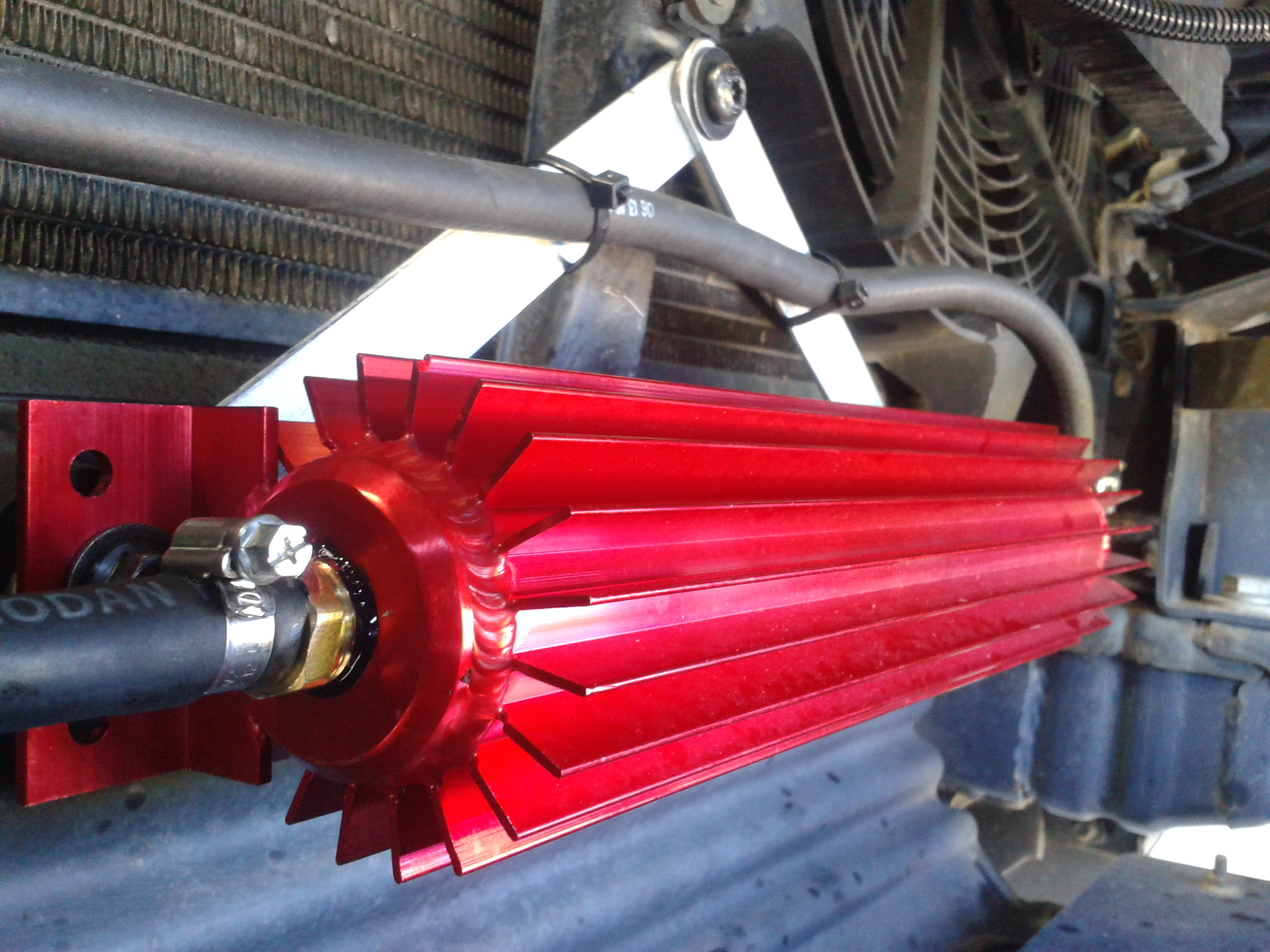

Rumcajs Posted December 29, 2015 Report Posted December 29, 2015 Finally fitted the fuel cooler, thanks Kenco Racing QLD and Mr Nissan providing some spare mounting holes and Volvo Trucks Corporation Volvo FH cab engine air intake piping rubber spacer it was a breeze to install. I can see fuel temperatures actually going down when engine load is off instead of just climbing up and up.... B/R

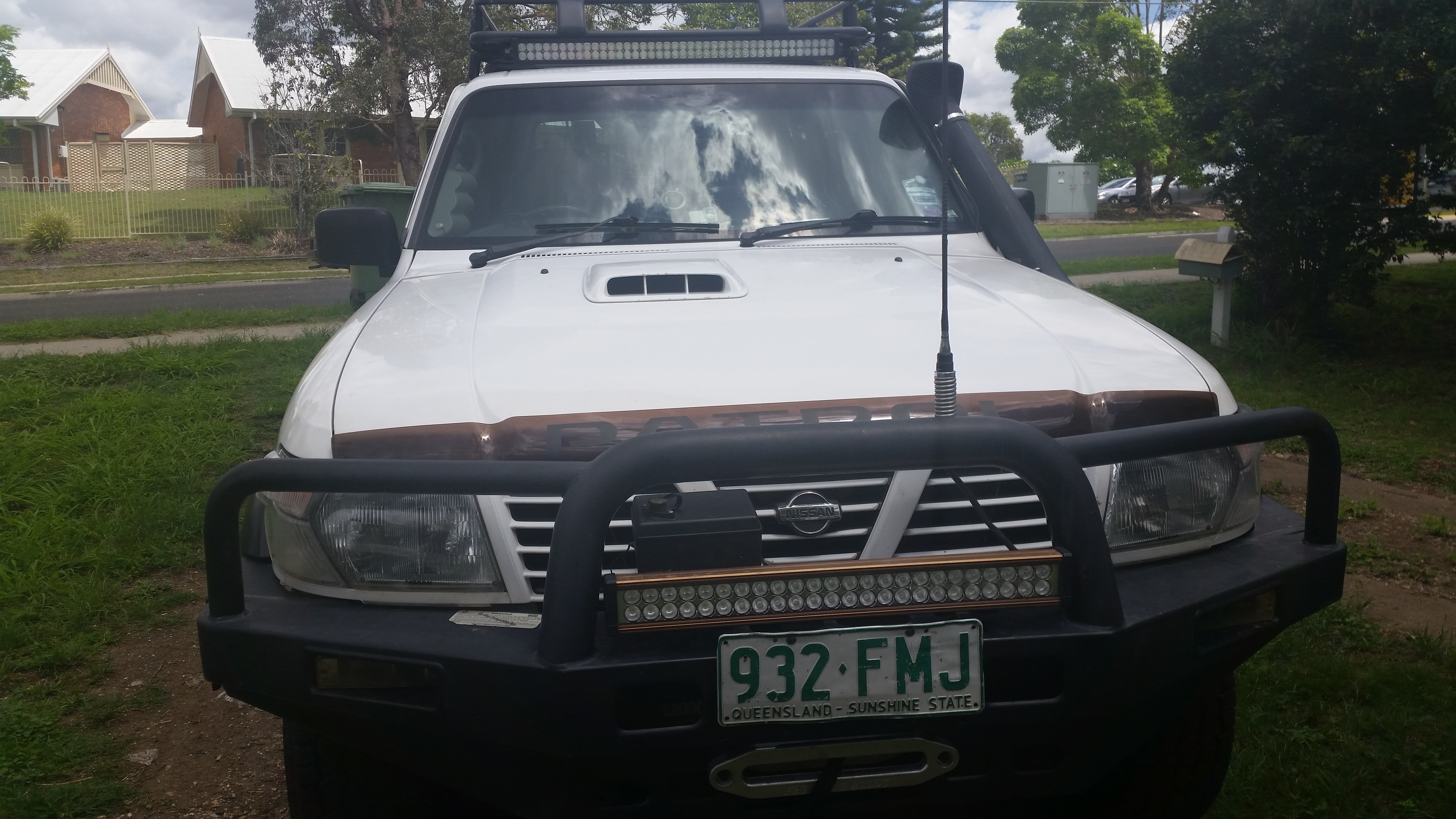

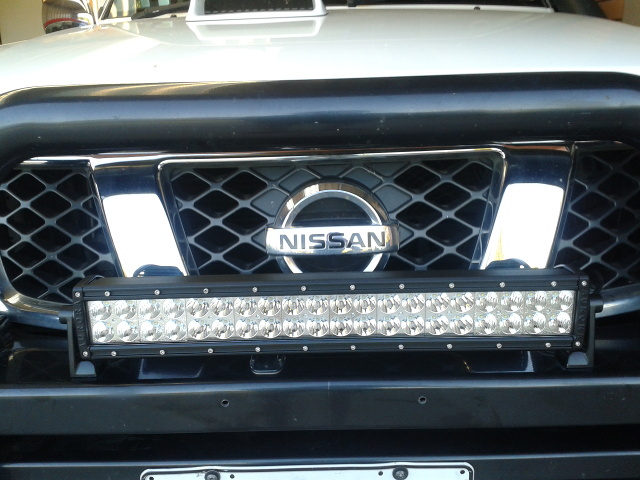

Rumcajs Posted March 15, 2016 Report Posted March 15, 2016 Upgraded to one of these ==> Let there be light! I'm speechless comparing the light output of this bar to my rusted old IPF spotties..... For those interested; Aurora 20" double row combo bar Regards

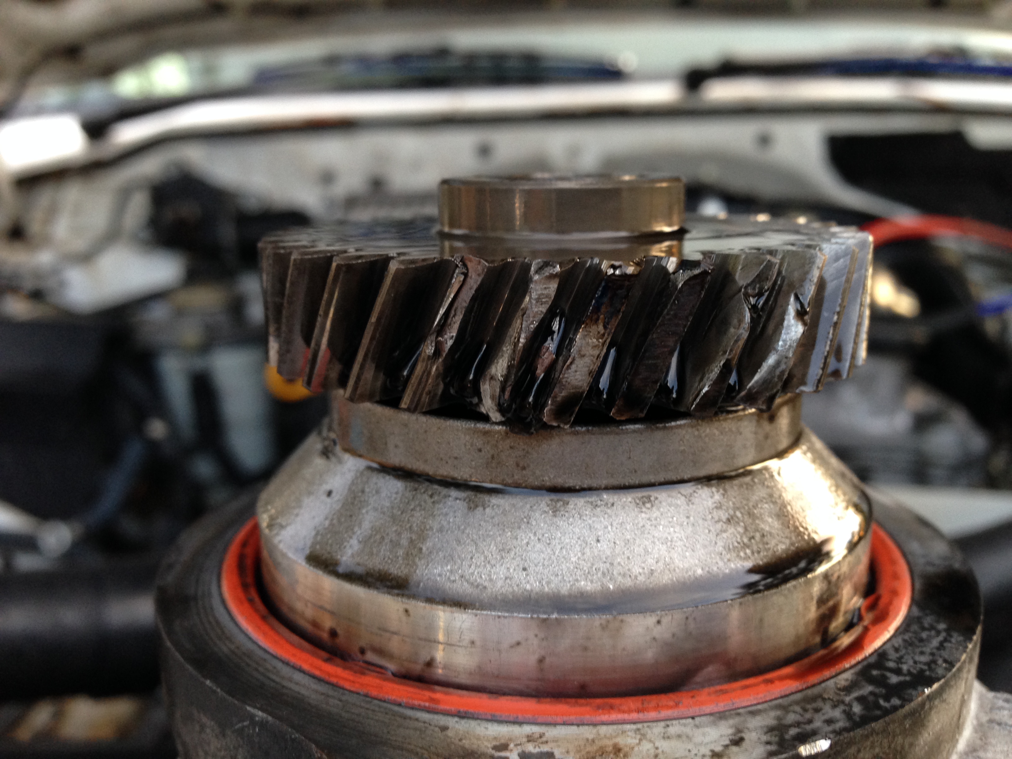

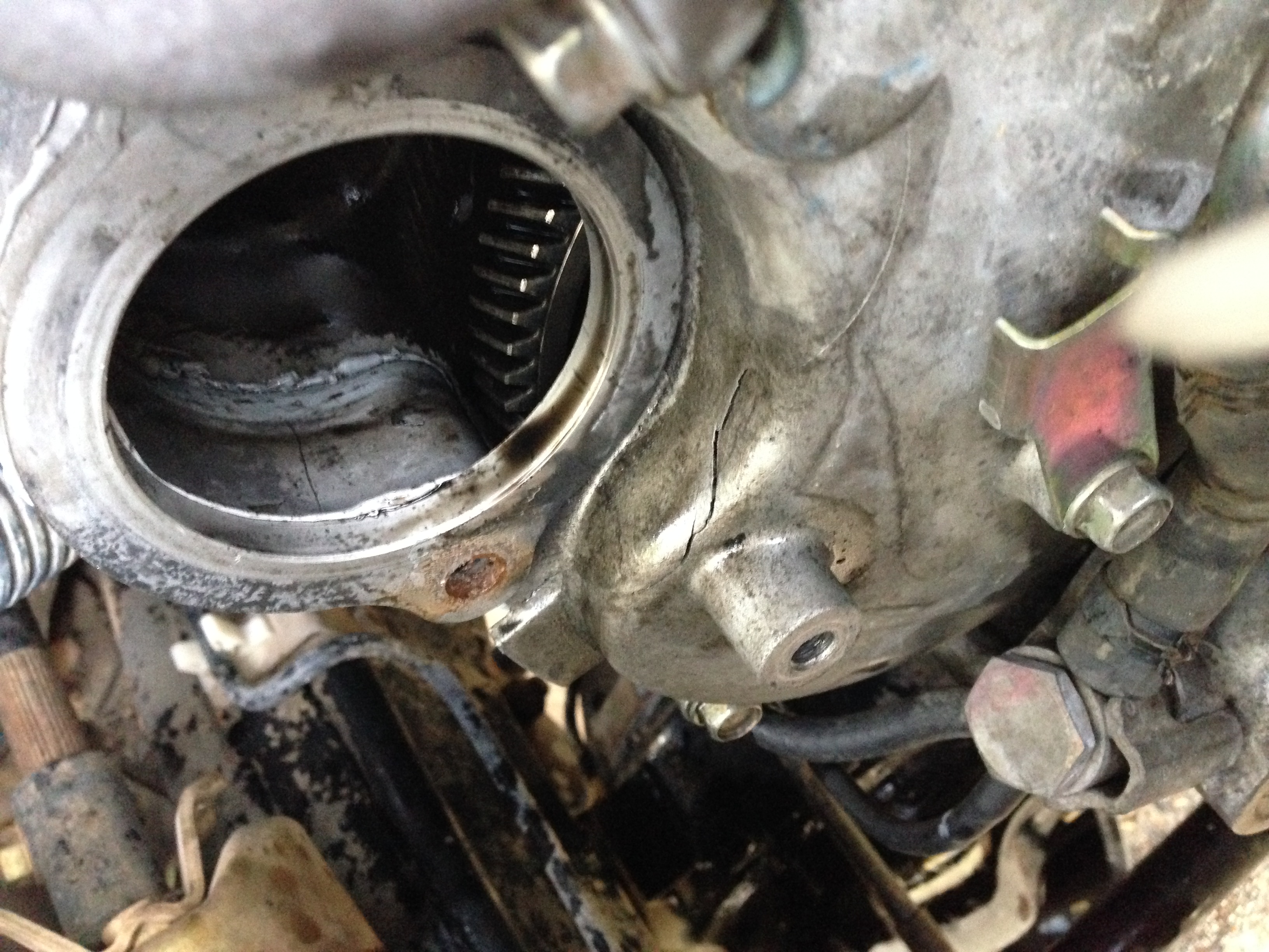

Rastas Posted April 7, 2016 Report Posted April 7, 2016 (edited) Thank you Rumcajs, you must have read my mind. 03 GU with ZD30Di. Time to rip it out and see what is to follow. I have reservoir removed already and looks like two bolts and a hose still to remove. Leaking on oil side of pump. Not so sure if oil is leaking from there now I can see better, might be below the power steering pump (vacuum pump?) Will give her a degrease and turn over to have a better looksy. Well bugger me. The mechanic in Oakey who rebuilt my motor late last year must have CRAFT's disease (Carnt Remember A F@$%&ing Thing) A bolt holding the steer pump on was loose and the other had several washers on it. Pic below shows the hosing for pump with a crack and the pump drive gear slightly knackered. Whilst finding out my new found problems 3 hose clamps were night tight or on properly and ther is an assortment of bolts and screws missing. Pondering the thought of not owning a Patrol now. Edited April 8, 2016 by Rastas
