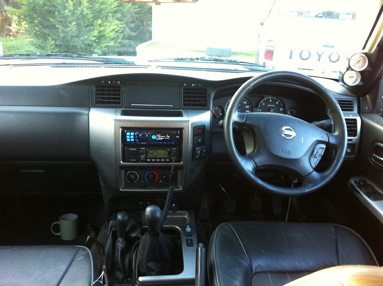

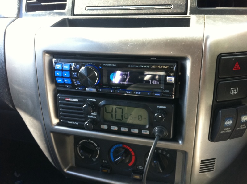

Jacket_1985 Posted May 11, 2012 Report Posted May 11, 2012 i like my GME tx4400's. they make a new tx4600 now with 80channels. love having a large forward facing speaker. and one din fits nice, where else could you put a uhf where it looks/works better?.
