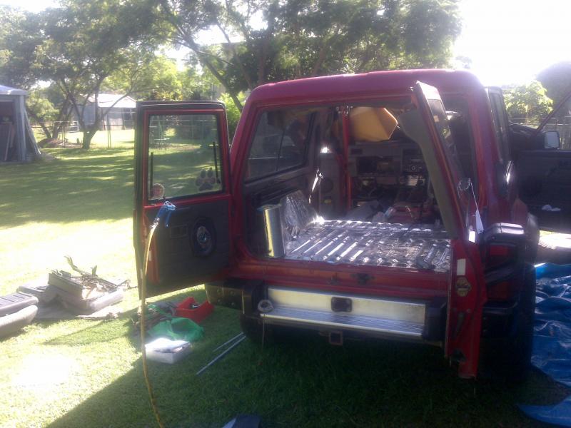

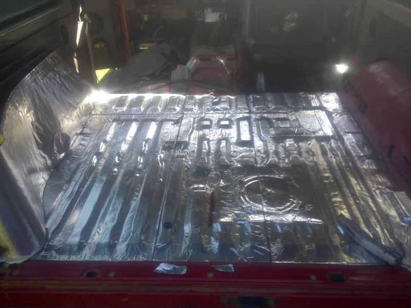

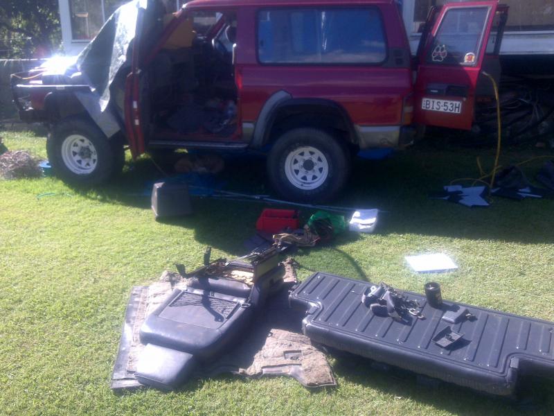

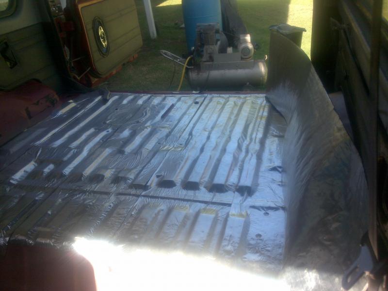

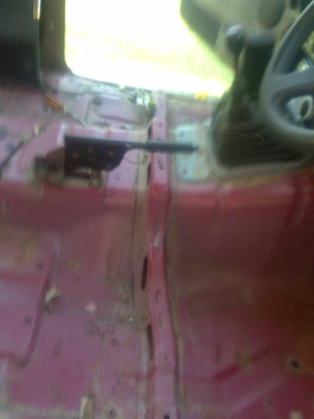

Fatboyz inc Posted May 4, 2012 Report Posted May 4, 2012 I have decided to sound proof and water proof and also rust proof al at the same time with a cheaper alternitive to Dynamat, you can find it a Bunnings or most hardwares it is called Weatherproof Tape... it is a bituman backed foil you can get different width rolls I went doe the one about a foot wide I needed two rolls at about $122.50 each compared to the Dynamat which would be around $5-600 to do exactly what I have done with this and it is the same thing (bituman backed foil) here are some pic's I also added an E.R.P.S. (Electronic Rust Prevention System) under the matting. heyhey, tailpipez and KMsMK 3
KMsMK Posted May 4, 2012 Report Posted May 4, 2012 It'd be good to see whether it does the trick long term. Good find
Fatboyz inc Posted May 4, 2012 Author Report Posted May 4, 2012 Thanks KMsMK I have done this to a few cars now and it does work a treat nice and quiet I used rust converter on any surface rust that was on the floor and the bituman tape seals the floor just like a lot of people use bituman paint as a rust preventive in thier underbody spaying the tape is much thicker and you only cut the holes out you need in your floor so you then rely on good door seals if you get stuck in water to hold that out the car is much quieter then when I first got it and you get much better sound out of your stereo to because of the acoustic effect from the matting.

heyhey Posted May 9, 2012 Report Posted May 9, 2012 Great! I was about to purchase a dynamat alternative off eBay for almost the same money. However, how thick is this Bunnings stuff?
Fatboyz inc Posted May 9, 2012 Author Report Posted May 9, 2012 The Bunnings stuff in about 1.5mm-2mm thick here are some pic's of the roll I just bought another roll to finish the car off it is $125 for a 10mroll @ 300mm wide and easy to use, cut and mould.

Bizz Posted May 11, 2012 Report Posted May 11, 2012 It's aprox 2mm thick as I've been looking at it my self but they do do a fire wall sheet which is 10mm thick that I've worked out to be about the same price per m2.
Fatboyz inc Posted May 11, 2012 Author Report Posted May 11, 2012 Nice didnt know bunnings sells that stuff, already got some dynamat, but if I need some extra stuff I'll be ducking into the local bunnings for sure. How do you find the rust prevention system? Do you think it has any effect? I had the E.R.P.S. brand on my old puslux, wich had a rust hole in the floor that I never repaired until I sold it which was 4years later and the hole never got any bigger and I am not that fussy when wash my 4b's so I believe in this system hence why I have put it in my shorty.
Sooty_10 Posted May 11, 2012 Report Posted May 11, 2012 How thick is the dynamat Sooty_10? Not 100%, but I can have a look at it tomorrow and maybe measure or see if I can find some info. But yeah pretty sure it is only a couple of mm thick. Got it off eBay about 6 months a go, for my cab chassis but never used it, was only about $240 for a bulk pack. Not sure how much of a wagon it would do, but if I run out I'll look at bunnings I reckon.
heyhey Posted May 20, 2012 Report Posted May 20, 2012 Just picked up a roll, decent enough looking stuff (smells strong though). Just wondering, how nuts should I go with this stuff? I'm not going to knock out the original bitumen soundproofing on the floor pan. I plan on running a bead of body deadner that I have left over, around the existing bitumen mat, the run a another lot straight over the top. With the pilars behind the front doors, it you put the mat on the outside or inside? Roof? Firewall already has material matting.
