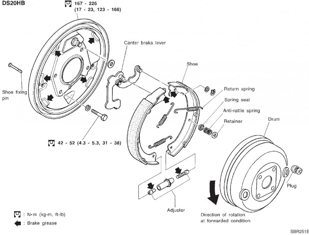

Rumcajs Posted February 11, 2016 Report Posted February 11, 2016 G'day, I don't know what it is like in GQ but on GU the adjuster for the brake shoes can be turned both ways, there is not so called auto adjuster which would normally be a part of hydraulicly actuated drum brake where movement would transfer on to a ratchet one way expander which still can be retracted. See pic attached: skid 1
